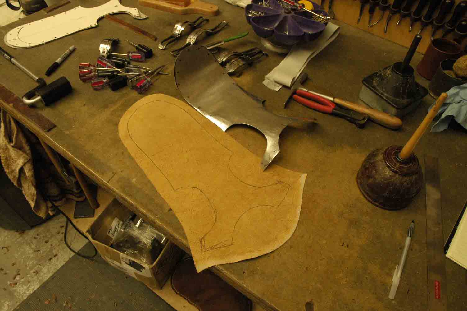

These three pics are of a strainer going in. The first shows 2 types of strainer. One that I make, and the other commercially available. The folks at Sheridan Leather Outfitters can set you up with good strainers, and most anything else you need for that matter.
